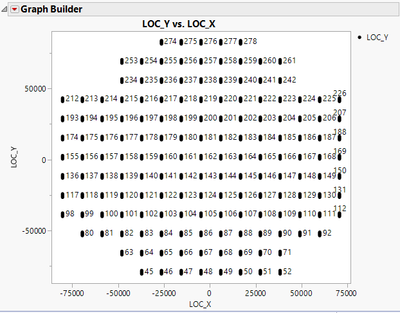

Hello,
I have a data set and I want to label my graph with respect to vales in a column. But the labelled column has repeated entries, is there any way to pick only first/last value of the label or any single unique value ?
In my attached data, I want to plot 'LOC_X', 'LOC_Y' and want to Label it with 'Area Code'. But in this data, there are 5 same values of 'Area Code' for 5 different sets of X, Y. And this creates a mess! Not sure if there is any solution for it.
In the alternate way, I have 'map boundaries' map installed but I do not know how to put 'Area Code' in it and if I use label option, I am ending up at the same place.
Any help here ?

Dear @HSS ,
you can label the first value, and unlabel the others by the attached script.
For Each Row(
	Row State( Row() ) = If( Col Rank( :Area Code, :Area Code ) == 1,
		Labeled State( 1 ),
		Labeled State( 0 )
Georg

jthi
Re: How to put only one value label in graph, if labels are repeated.
I'm not too familiar with this sort of coordinated data, but maybe you could calculate some sort of value based on LOC_X and LOC_Y and Area Code:
If(
	:LOC_X + :LOC_Y == Col Max(:LOC_X + :LOC_Y, :Area Code), :Area Code,
	Empty(), .
Select Missing values based on this and unlabel them
-Jarmo

Hi Jthi,
Thanks for for the reply. Yes, this is one solution. And I am also doing along this line only.
Many thanks again for your response.

Dear @HSS ,
For Each Row(
		Labeled State( 1 ),
		Labeled State( 0 )
Georg

Thanks George.
I guess this is better/right way of doing it.
