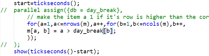

That script,
m[a, b] = a > db[b];
is executed about 7 million times per second (4-CPU 17.5G VirtualBox). I also ran out of memory, and that means paging. Paging will cause a dramatic slow-down, perhaps at i==5.
Column 4, the nested-loop comparison, was made like this (screen capture...computer busy trying to get to 1900 seconds on row 3):
This is the kind of problem parallel assign was designed for. Part of the speed comes from C++ loops rather than JSL loops, and part from threading.

That script,
