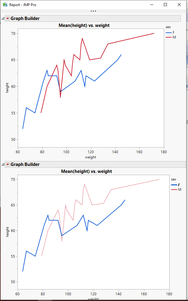

The issue is that you are appending the Report for the Graph Builder, not the Graph Builder Object.  Take a look at the results from the below script, and you will see that the appended report becomes a static graph, where the embedded object does notembedded.PNG
names default to here(1);
dt=open("$SAMPLE_DATA/big class.jmp");
mygb = Expr(
gb = Graph Builder(
	Size( 528, 456 ),
	Show Control Panel( 0 ),
	Variables( X( :weight ), Y( :height ), Overlay( :sex ) ),
	Elements( Line( X, Y, Legend( 7 ) ) )
mygb;
nw = new window("Report",);
nw << append(report(gb));
nw << append(mygb);

txnelson
Re: Unable to Highlight on Graph Builder and Select Corresponding Rows
mygb = Expr(
gb = Graph Builder(
	Size( 528, 456 ),
mygb;
nw << append(mygb);
Jim
