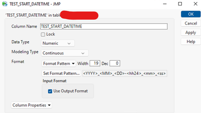

I have an input table with a column TEST_START_DATETIME that JMP initially recognizes as a Character/Nominal Data/Modeling Type as shown below.
I can set this column as a continuous date/time format type using the Column Info dialog.
Note the text is shifted to the right, indicating it's a cell.
However, when I try to do this in JSL I get an empty column. It looks like it converted the column to numeric type before applying the format type, causing it to get deleted.

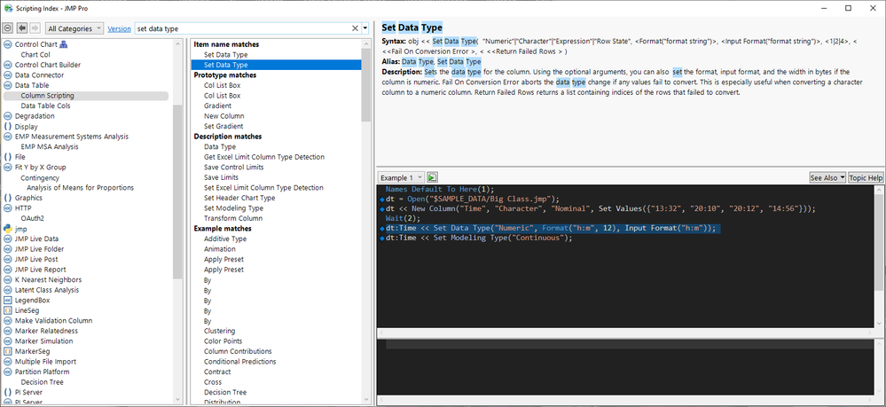

You are doing << Data Type("Numeric") first -> it will be converted to number too early. Do it manually in JMP, look at the log and copy the script.
// Change column info: Column 1
Data Table("Untitled"):Column 1 << Set Data Type(
	Numeric,
	Format("Format Pattern", "<DD><-><MM><-><YYYY> <hh24><::><mm><::><ss>", 19, 0),
	Input Format("Format Pattern", "<DD><-><MM><-><YYYY> <hh24><::><mm><::><ss>", 0)
) << Set Modeling Type("Continuous");
Scripting Index also has an example on how to change data type while applying formatting
