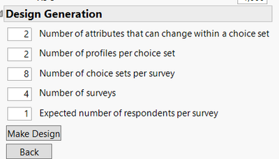

In order to set up your design, you have several parameters to define in the Design Generation panel :
  • The "Number of attributes that can change within a choice set" is the number of factors that you can vary the levels between experiments (called "profiles") in the choice set. In my design, only 2 of the 3 factors vary between the 2 experiments in the same choice set (example for survey 1, choice set 1, X1 and X2 vary, but not X3 (fixed at L1)). This should answer your last question ?
  • The "Number of profiles per choice set" is the number of experiments in the same choice set that the respondent will have to choose from. In my example, I let this value to 2, but you can augment it if you would like to reduce the number of choice sets/surveys for example.
  • The "Number of choice sets per survey" : collection of profiles.
  • The "Number of surveys" : collection of choice sets.
  • The "Number of respondents per survey" : if you have several respondents, change the value to the number of people answering each survey, so that each respondent has its own column for the values. It will be automatically taken into account in the script "Choice" for the analysis, filling the "Subject ID" role with the "Respondent" value.
More infos on terminology here : Choice Design Terminology

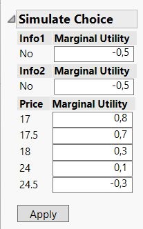

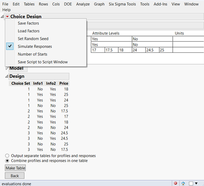

Yes you can simulate data when creating your design, go into the red triangle next to "Choice Design" and click on "Simulate Responses" :
It will create formula columns for probability calculations and choice simulated, depending on the marginal utility values entered :
You can then launch the script "Choice" (or go to Analyze, Consumer Research, Choice) and analyze the simulated Choice response. You will have access to various Profilers (utility, probability profiler) and comparison analysis, as well as Willingness to Pay metric if you have specified your variable Price as Continuous numerical factor type.
