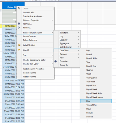

Not sure how you wish to do it, but could you just add time of day to the days? You can create Time Of Day column using right click quick formula on your Date/Time column, then add that to Day column BUT remember to divide the time of day by In Hours(24) (or 60*60*
24) to turn it into "days".

How should the days be calculated? First date of a Run is 0 and then add days after that? If that is the case, create a date column
Then use
(:Date - Col Min(:Date, :Run)) / In Days(1)
in separate formula
-Jarmo
