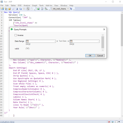

JMP 16 user here. I have an add-in that pulls data from a work database and creates a table. In the particular file I'm interested in, there's data going back 20 years, but I only want data from the last 6 months.
I managed to build a query that filters the data from the source table and puts it into a new subset table. The query filters based on any date range I put in with the filter being set to prompt for an input whenever the script is run as in the image below.
The query does it's job and gives me the data from the range of dates I'm interested in. I've managed to get to script working as follows - input from source database -> query source table and filter based on date range -> open up a new table with new data.
What I then want is to plot the new data in Graph builder. I would like for this plot to automatically show up and populate whenever I run the script with the data from the range of dates I chose. I've tried copying the graph builder script to the ChemicalUsageQuery as in the above image, but when I run it, it either doesn't populate, or populates with data from the original source database table and the dates are change to 1904.
I would like for the script to run, prompt me for a date range, open up a new subset table, and then automatically graph the data.  Any help would be much appreciated.
Thanks,
ih

I think you just need to save a reference to the new table when you open it and then send the graph builder script to that reference. Just running Graph Builder() will run it against the current data table, which might not be the one you want.  For example note the role of dt2 in this script:

Re: Trying to have Graph Builder automatically plot data from Filtered Data Table Query
Thank you so much. It worked.
