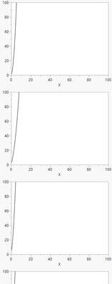

Tried this but I need to raise x to the power 2 and that seems to be where it fails.
Names Default To Here(1);
dt = Current Data Table();
nw = New Window("window", vlb = V List Box());
For Each Row(dt,
	Eval(EvalExpr(
		vlb << Append(Graph Box(Y Function(Expr(dt[Row(), "HL_HR1_R"]) + Expr(dt[Row(), "HL_HR2_R"]) * x + Expr(dt[Row(), "HL_HR3_R"]) * Power (x, 2) ,x)));
Slán

How does it fail?  Any error message?  Your code works when I run it on a dummy table with four rows.  I just might want to adjust the axes some.
SpannerHead
Level VI
Re: Trying to avoid Transposition
Error was self inflicted, you're right, it does plot.  I have 2 remaining challenges.
1 I would like all the plots on a single graph.
2 I would like to limit x for each plot to a value stored in another data column.  Generally, that value is >100.
