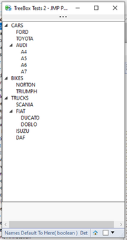

I am building a dynamic tree box based on a directory structure.....so I don't know in advance how many roots and nodes there will be in the tree. The final nodes of the tree could have the same name. I then put the tree into an application.
When a user clicks on a node I want to re-create the 'Path' from that node back to the root.
So if someone selects say 'Ducato' I want to be returned 'Trucks - Fiat - Ducato' Similarly if you picked a node that was not the final leaf it would also work. For example selecting 'Audi' would return 'Cars - Audi'
