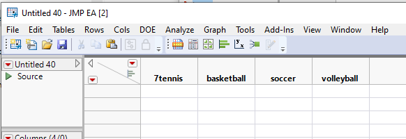

Re: Transpose column, make transposed rows headers in JMP12
@brady_brady probably provided you with better solutions, but if all you want to do, is to create an empty data table where the column names are the value from the first row, the following will do a real simple job of that
dtNew = Data Table( "sports" ) << Split(
	Split By( :Items ),
	Split( Transform Column( "Transform[Items]", Nominal, Formula( . ) ) ),
	Sort by Column Property
dtNew << delete rows(1);
Jim
