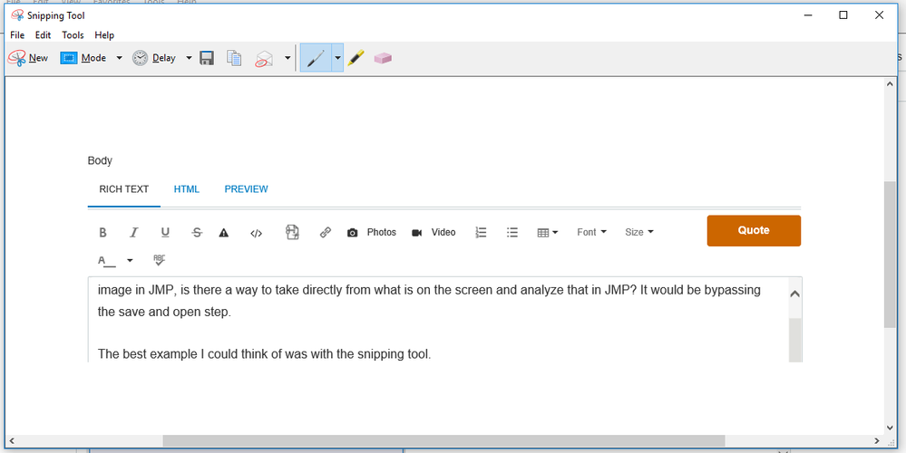

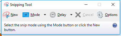

I want to be able to perform image analysis on a "screenshot" of the screen. You could always take a screenshot, save the image, then open it in JMP. Instead of having to do this, is there a way to take directly from what is on the screen and analyze that in JMP? It would be bypassing the save and open step.
The best example I could think of was with the snipping tool, where you "snip" from the screen, then what you snipped is open in a new window. (Sorry for the screen-ception below)
