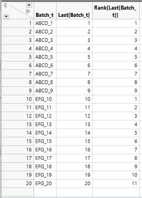

Without knowing how your categorical variable is formatted, it's difficult to suggest a solution. However, assuming that there is at least some numeric value in the column that can be extracted, you could use the Rank() function to scale things. I've attached a sample table to show how the formulas work.

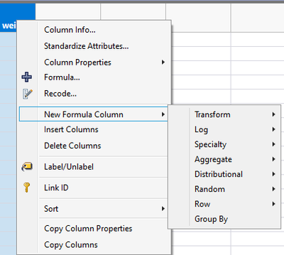

If you right click a column header then select New Formula Column, you'll see a list of the formulas that JMP will automatically make for you. For me, this is about 90% of all the formulas I build in JMP. To make the formula columns in the sample table, I used this, then modified the formulas a bit in the formula editor.

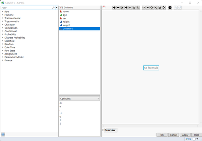

To use the formula editor, right click on the header and select Formula. There, you'll see a searchable list of all the possible formulas on the left.

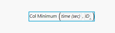

  1. Right click Time column, select New Formula Column...Aggregate...Minimum
  2. Right click new column, select Formula, change formula to include ID as a "By" variable (third argument)
  3. Rename this column to "Start Point"
  4. Select both Time and Start Point columns, right click on column header, select New Column Formula...Combine...Difference
