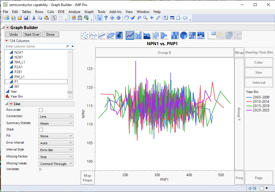

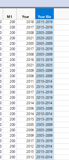

Just create a new column, in my example I call it Year Bin.  Use the formula:
If(
	:Year < 2010, "2005-2009",
	:Year < 2015, "2010-2014",
	:Year < 2020, "2015-2019",
	:Year < 2025, "2020-2025"
Which yields the following graph with the year bins as defined in the formula
If(
Jim
