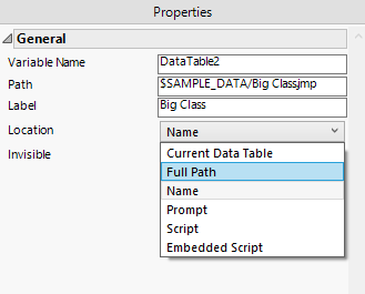

If you check the box, both tables will be referenced by name, and the script should run immediately if you have open tables that match the names.  There are other options for choosing the tables that can be set by selecting "Show Properties" from the Dashboard Builder red-triangle menu.  For each table referenced, there are options for how to set the data table:
The prompt dialog that you are seeing is the "Prompt" option, which is also the fallback solution if the table has not been set through one of the other options.

c. In Properties, by default, for Location: "Name" is selected for the data tables & as suggested i changed it to "Prompt". In my case i have 2 Data Tables.
d. When i select "Preview Mode" it doesn't prompt a table to select the corresponding data tables, however when i click the "Run Dashboard" it is prompting the table to select the corresponding data table even after selecting "Prompt" for "Location". Please let me know if i have missed any information to include.
