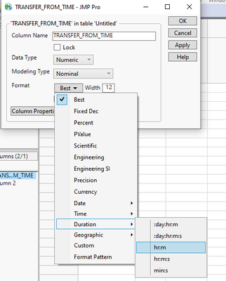

Try using duration format:
So most likely something like this:
Column("TRANSFER_FROM_TIME")<<data type(numeric)<<format("hr:m:s", 12) <<modeling type(continuous);
-Jarmo

Thanks - this does exactly what I wanted.
