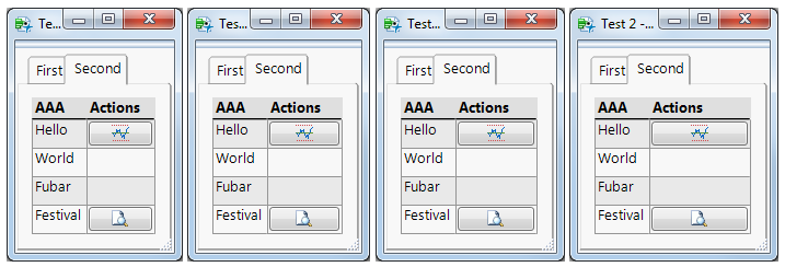

I have a weird problem in JMP 12.2.  When I run the code below, successive switching between the tabs using the button on the first tab yields button boxes that grow in width.

Here's what it looks like:
To see the effect, run the code and click on the "Go to Second" button.  This will switch to the "Second" tab.  Now click on the "First" tab and click the "Go to Second" button again.  Keep doing this and you'll see what I'm talking about.
Is there a way to force a button to be a particular width?  I tried putting a button inside a border box and setting the width of the border box, but that didn't work.  BTW this behavior is not evident in JMP 13.2.

Found a fix:
b1 << set max size(30, 50);
b4 << set max size(30, 50);
This seems to do the trick.

Looks like this issue was fixed in JMP 13.
