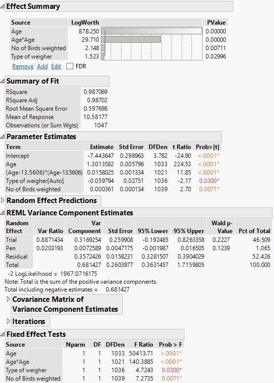

I imported your workbook and changed some data column attributes in JMP.
I used a Partition model to assess important variables. Age is by far the most important variable.
I used all the variables as predictors in a linear regression model for body weight. I treated trial and pen as a random effects and all the rest as fixed effects. Here is the initial analysis:
The variance components analysis of the random effects suggests that there is no significant effect (difference) between trials or pens. Age exhibits a non-linear effect. There is a difference between the type of weigher and a dependence on the number of birds weighed.

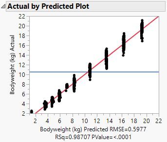

This plot shows the predictive performance of the model:

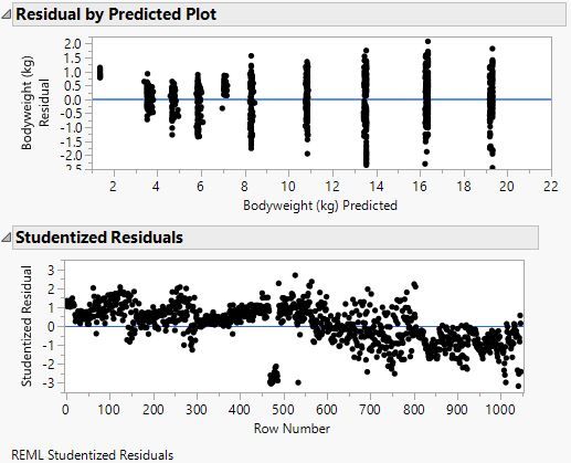

I also examined the residuals to look for issues with the data or model assumptions.

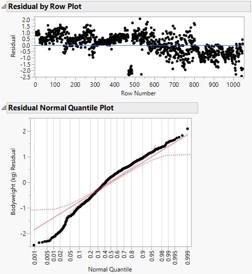

You can see in the detail that there is still some bias in the model for the lowest body weights. There is also a cluster of weights in the middle of the range that are distinct from the other neighboring weights.

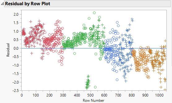

I assumed that the data were recorded in the order they were generated. If so, then there are still patterns to be investigated. I colored by Trial and marked by type of weigher.
