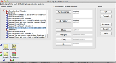

Here is a screen shot of how it looks when I am in fit y by x. I cannot see quality and reliability anywhere?4755_Screen Shot 2014-01-16 at 16.30.54.png

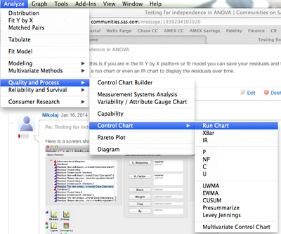

I apologize for the confusion. Once you save your residuals to your data table from the Fit Y by X,  you can launch the Analyze>Quality and Process platform and create a run chart and or/IR from there.

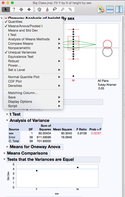

Go to red triangle and select Unequal Variances....
