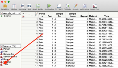

I tried a 3-factor anova:
However under effects, it just says LostDFs. Either because there are not enough points or because there are combinations missing.

1. If you look at the file you posted, the Time column is set to nominal.
2. Without knowing practical significance, it is impossible to analyze the data.
3. By normalizing you are accounting for the "expected" differences between materials.  You could try deviation from target or mean.
4. The repeats are not considered independent events and therefore are not additional degrees of freedom.  You can look at the individual data points graphically fords, and if there are no outliers, then summarizing those data points is appropriate to analyze the treatments.
5. I can't understand how a sample from one material can be "identical" to a sample from another material.  This is impossible.

1. Your Time column is set as nominal, but I believe it is continuous.

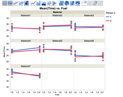

4. You should evaluate the repeated measures within treatment before summarizing that data.  Here is a range chart showing those measures are consistent, so summarizing this data with a mean (and standard deviation) is appropriate.
5.  A questions about your data; You use the same designation for Sample Name across multiple Materials?  It doesn't seem likely that Sample1 for Material1 is identical to Sample1 for Material2?  These may be nested. Lost DF's is usually be cause you have over specified the model given the number of data points.  It also looks like there is a bit of imbalance to your data set?  If you have 7 materials, 2 fuels, 2 people, 2 sample sets and 3 sample names per material and 3 repeats, you should have 504 data points?
A bit of a look at the data:

1. I believe the time column is set as continuous, not nominal.

Apologies, I don't know what happened to the time column, should have been numerical, you're right.
