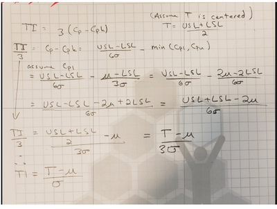

I went ahead and re-tried the derivation just to check.  T = target.   We're also assuming that the Target is centered in the process.  That was needed for this derivation to work.  Wasn't sure how it works with a non-centered target.  Also I only solved it for Cpl, but I'm fairly certain the only difference on Cpu is that it flips the sign which is how TI always stays positive.  I'd say there's a 50/50 chance i messed up the math here.  But from what I can tell it looks like the USL/LSL fall out.

You know I finally looked at the slide deck that's out there for the Fall Technical Conference on the Target Index and it actually shows that reduced formula as the starting point.
What's weird is that they start with that and then go to Cp-Cpk, even though the equation still reduces back to the equation without the USL/LSL.  Not sure I understand why they did that.    It's kind of like saying that PPK = Dragon Population + min(USL-xbar,LSL-xbar)/3sigma - Dragon Population.
I mean I like dragons as much as the next guy but PPK isn't a great dragon indicator.  And TI isn't related to USL or LSL.
