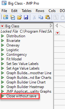

Another option is to save a script to close the data table when you open it:
Names Default To Here( 1 );
dt << New Script( "Close without save",
	current data table() << Close Window;
