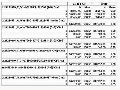

But for some reason one data table is not putting the 0,1 and 2 as columns in the tabulate, but rather as rows under each snp.  Looks like screenshot 2.

I tried making a script of the correct one to bring into the incorrect one to manually change it but JMP crashes each time I try to do that.  The correct table script says Row Table( columns by categories... and the incorrect one says Row Table( Grouping columns...

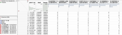

here is a piece of it as a screenshot.
I may have found a workaround without trying to use scripts.  Funny how when you look at instructions (user guide online) you learn things.  I've always known about options under red triangles, but apparently you can right click on the column name and get more options. One is to combine tables, (columns by categories).  This did what I wanted.  Apparently the issue was lots of missing data.

Can you give us an example of what your original data table looks like including what the data type and modeling type is for the SNPs (since they are columns).
