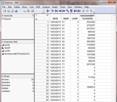

I am trying to tabulate a table and use a filter simultaneously to create a table that pulls out 6 rows of data that I can then join to another data table. The table that I see in my control panel is correct but when the script runs and creates the data table I am getting different data. Below is the code I use and 2 screen shots. Why is the table created different than the table seen in the control panel?

From the tabulate control panel. This is the table I want:
This is what I get when I run the script:
