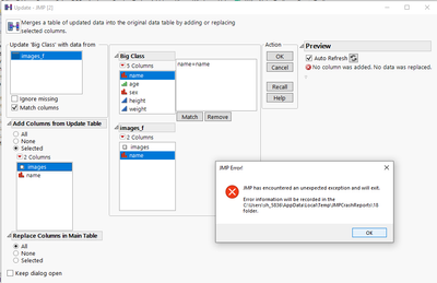

There is a strange bug on our systems with the attached file.
Some info about the file: The images are loaded incorrectly as
New Image( Char To Blob( "", "base64compressed" ), "jpeg" )
When we try to update  Big Class.jmp with this file, a warning pops up:
and when I change the settings to:
... JMP crashes.
We opened a ticket at JMP support: TS-00173091.

Got it.  I reproduced the crash after changing the settings to match yours.

The crash is not caused by the update (click on OK) - the update runs on my system without an issue.
It seems to be the preview.
deselecting and selecting the "images" column leads to a crash - reproducibly.
