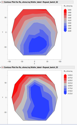

I have a script that takes a standard contour plot output and rearranges the plots into columns.
Goes from
to
The placement of the text boxes is causing the script to misfire.
Is there a different way to get the result?  If not, can I adjust the present script somehow to sort it?  I was wondering if the parent script could execute a find/replace on the child script to perform some adjustments?

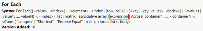

Many many Thanks to the programmer of the  For Each function !!
wonderful : )
It works with any Expression, not just with List, Associative Array and Matrix : )

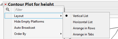

If you can use JMP18 you can just modify the layout from the highest level red triangle

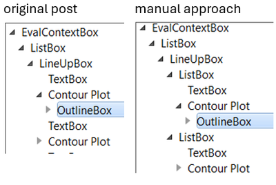

You could collect the scripts of the OutlineBoxes, encapsulate every (Where information + plot)  inside a  V List Box and arrange the V List Boxes via the Lineup Box :
// ask every Outline Box for a scriptable object
obs = (current report() << xpath("//OutlineBox")) << get scriptable object;
// ask the scriptable objects for a script
scripts = obs  << get Script;
// prepare a template LineUp Box
myExpr = Expr( Line Up Box( N Col( 3 ), Spacing( 2 )));
// wrap the scripts with V List Box and put them into the template
For each({script}, scripts,
Eval (Substitute(Expr(Insert Into(myExpr, Expr(V list Box (_content_)))), Expr(_content_), Name Expr(script)))

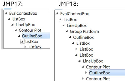

@hogi wrote:
... Is quite robust. It works with JMP17 (talking to the first plot)... and JMP18 (talking to the Group Platform)
Oh, this statement just refers to the way how to get the groupby script:
(current report()["Contour?"] << get scriptable object) << get by group script
not for the complete thing ...
In JMP 18 and later, the script returns a GroupPlatform - and Lineup Box is no longer possible to control the layout.
Then you can skip this outer part and directly use the GroupPlatform to control the layout (red triangle options mentioned by @jthi ).
Tree structure via Lineup Box (group by script)
[selected Outlinebox = 1st plot]
Tree structure via the previous approaches:
