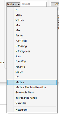

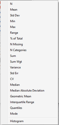

Another thing which I really miss a lot in Table Summary:
Median
Sure, there is Quantiles - but with an additional Median, things would be a bit easier:
jthi
Re: Table summary: "N non-zero" ?
Summary does have Median (but it isn't close to Mean so it is fairly easy to miss)

hogi
Level XIII
Ah, right - there is definitely a median -- also on my system :)
looks like I got trapped in some weird belief.
