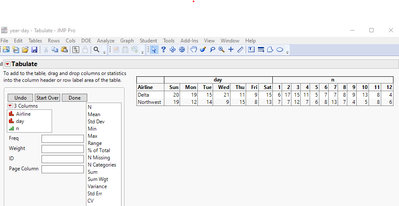

Yes you would have to run separage Summary Platforms and then Join them together to get what you want, or you  could run a Tabulate Platform and get what you want in one step.
Names Default To Here( 1 );
dt = New Table( "year/day",
	add rows( 200 ),
	New Column( "Airline",
		character,
		set each value(
			aList = {"Delta", "Northwest"};
			aList[Random Integer( 1, 2 )];
	New Column( "day",
		character,
		set each value(
			dList = {"Sun", "Mon", "Tue", "Wed", "Thu", "Fri", "Sat"};
			dList[Random Integer( 1, 7 )];
	New Column( "n", ordinal, set each value( Random Integer( 1, 12 ) ) )
tab =Tabulate(
	Add Table(
		Column Table( Grouping Columns( :day ) ),
		Column Table( Grouping Columns( :n ) ),
		Row Table( Grouping Columns( :Airline ) )
tab<<make into data table;

Hi @txnelson, thank you for the ultra-fast response.
One example where Tabulate is really ahead of Table/Summary :)
nice flexibility of  hierarchical and side-by-side grouping and subgrouping :)
