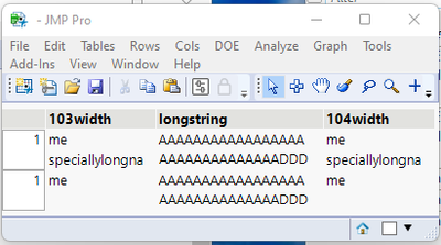

Seems like 103width is being wrapped and only second line is being show.

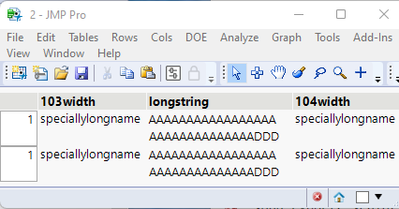

I ran your script and got different results.
and even more confusing results by adding a second line to the table
Using Col Box() with embedded Text Boxes seems to help

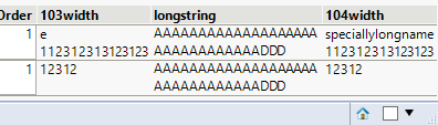

Second case is a bit worrying, as it looks like that rows are getting mixed up somehow. Most likely getting text from wrong row:
 (changed long_str = "11231231312312312312"; for second row).
Using Col Box with textboxes might be the "only" solution for now. Too bad you can't click and highlight rows with just setting tb << Set Selectable Rows(1); when using col boxes.

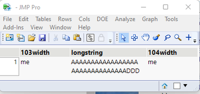

Also because Table Box seems to have fixed height for each row, it might be beneficial to wrap Text Box() with Scroll Box() (this will make the column a bit wider if scroll box appears)
