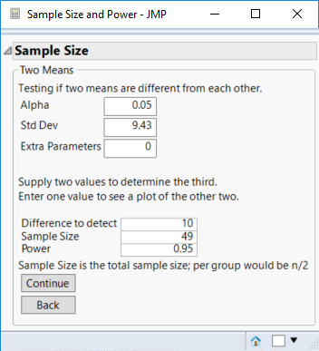

I want to determine the sample size for a two sample equivalance test.
I would like alpha and beta to be 0.05.  A practical difference is <-10 or >10.  My standard deviation is 9.43.
How would I set this up using the one sample test sample size in jmp?  Would you please be specific as to what I should enter in each field.
Re: TOST Acceptance criteria and Sample Size
*** NOTE 1: I updated my original reply because it did not address the two sample test for equivalence. ***
*** NOTE 2: This method is for a hypothesized difference. It should NOT be used for calculating the sample size for equivalence.
I believe that you determine the sample size for a TOST of equivalence exactly the same as a two sample test of the mean. I don't have the paper handy (it is an old one) but we get lucky here and they are the same. Select DOE > Design Diagnostics > Sample Size and Power. Click Two Sample Mean and enter your values as seen below, then click Continue to obtain the sample size (49, or 25 for each group, in this case).
I will investigate further when I get a chance to determine if there is another way or if I was wrong that you can use this method.
I am trying to do a two sided equivalence test.  When I ran it through Minitab I got 24.  I also used the folowing formula = (2*((-1.96 -1.6449)^2)*9.43^2 )/10^2 in Excel and got 23.11.
Please advise how I can obtain this from JMP.
I don't think that anyone should use the method I showed most recently for a two sample test. That result is for the hypothesized difference, not equivalence. MINITAB and your hand calculation provide the sample size for one population assuming a balanced design. I implemented the computation as a JMP script:
