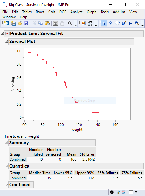

The non-parametric estimate of the survival probability is constant over a given interval. For example, here is an analysis in which I want to estimate the survival at 132.

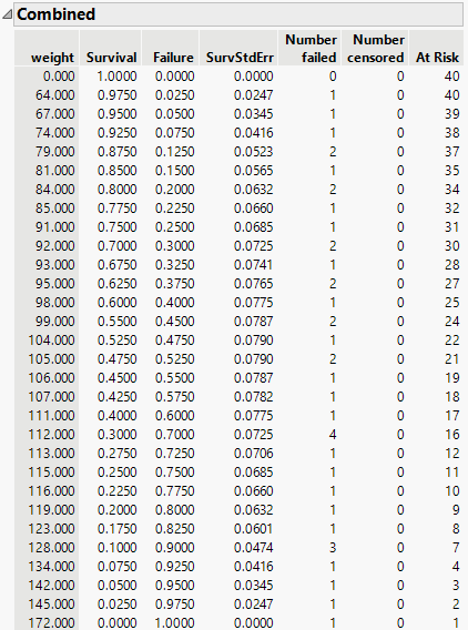

Open the Combined outline in the Survival platform and find 132 in the table.
The estimate is 0.1 over the interval [128,134].

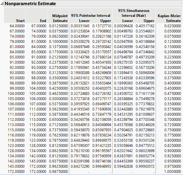

The Nonparametric Estimate in Life Distribution provides the same information in the last column: 1 - failure = survival = 1 - 0.9 = 0.1. Many analysts prefer the mid-point estimate to the original K-M estimate.
