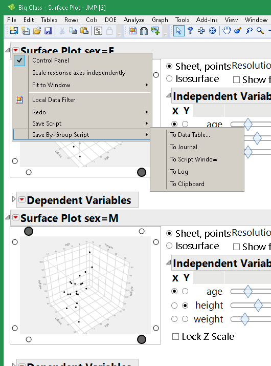

Craige_Hales
Re: Surface Plot: Automating the Display Editing
change the where(...) to by(:RunID)
If you use the red triangle save script, one of the choices will be for the by variable.
Option to create the script with by group.Option to create the script with by group.
Craige
