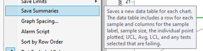

You might have to use << Save Summaries instead of << Save Summary Table
Names Default To Here(1);
dt = Open("$SAMPLE_DATA/Quality Control/Coating.jmp");
obj = dt << Control Chart Builder(Variables(Y(:Weight), Subgroup(:Sample)));
obj << Save Summaries;

Thanks it worked, getting used to JMP Script :)
