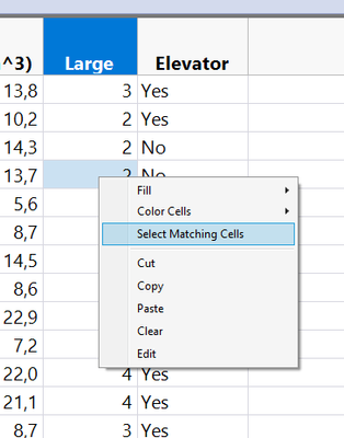

An easy ad hoc solution could be to right-click and press select matching cells and then hit delete.
Does that help?

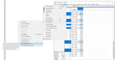

You can do it using the row selection menu.
First, you find and select duplicates (see below).
Then, you simply delete the rows selected (same menu, Rows>Delete Rows)
Be aware that you get different answers depending on the columns you are selecting (if none, JMP looks at all columns).

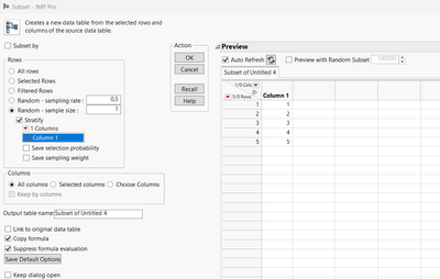

Another option could be to use the platform "Subset" available in the menu "Table".

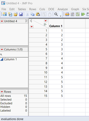

Here is my example datatable before (with duplicate values):
Then using the platform "Subset", specifying that I want only one value for each levels/unique values of my column (using my selected column as a stratification), you end up with the result you want :
As you can see, there are many ways to do this in JMP ;)
