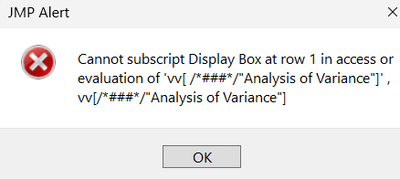

Forgot to post the error I get with the JSL
Thanks

txnelson
Re: Summary Statistics of all numeric columns by grouping variable
The JSL for a JMP Platform that generates an Analysis of Variance is missing from the code.  The way the variable "vv" is being used in your supplied JSL seems to be pointing to the Output Display from a Oneway analysis or a Fit Model.  I find no such reference in the code you supplied.
I have made a guess and added in a Oneway to the code.  It generates output, but you need to verify that it is what you want.

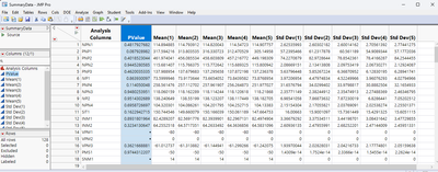

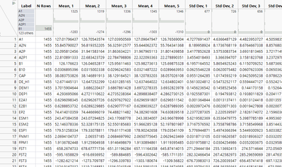

hogi
Level XIII
As an alternative suggestion, you can generate a temporary stacked table  - and use Tables/Summary in combination with the options Group (original column) and Subgroup (split):
dt = Open( "$SAMPLE_DATA/Semiconductor Capability.jmp" );
tmp = dt <<
Stack(
	columns( Column Group( "Processes" ) )
tmp << Summary(
	Group( :Label ),
	Mean( :Processes ),
	Std Dev( :Processes ),
	Subgroup( :SITE ),
	statistics column name format( "stat" )
