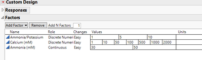

Therefore, I set up the three factors I want to investigate: 1) calcium concentration, 2) the ratio of ammonia to potassium, and 3) Ammonia concentration.
Here I included 7 different levels of calcium concentrations as it changes the yield across a broad concentration range of calcium. We also want to have three discrete ratios of ammonia and potassium. Then I also want to investigate whether ammonia concentration impact the yield.

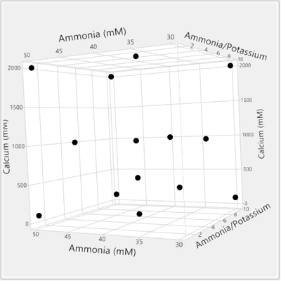

Below is what JMP suggested, and I am quite satisfied as: 1) it suggested 14 runs within the resource limit. 2) it efficiently fills up the design space.

Concerning your factors, I don't understand why you set the Ammonia/Potassium ratio factor as discrete numeric ? You can set up this factor as numerical continuous, and add a quadratic term in the model panel so that the resulting design will include a middle level. The Calcium concentration factor does cover a wide range, but again, you're not forced to use a discrete numeric factor to cover a broad range of levels : specifying a more complex model with higher order terms (set as "Necessary" or "If Possible" to not augment the required run size), and/or using a log scale for this factor, since it covers very different orders of magnitude for the concentration (so instead of having 1/10/50/100/500/1000/2000 you would have 0/2,3/3,9/4,6/6,2/6,9/7,6 with a log-scale, which would enable to cover more homogeneously the different concentrations magnitudes compared to the original scale with a numerical continuous factor).

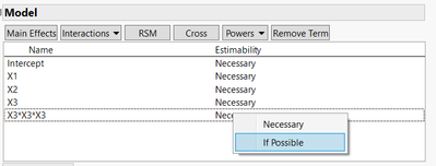

Yes, in order for the Custom Design to provide more than 2 levels for any numeric continuous factor, you have to include higher order terms in the model, like quadratic effects (3 levels), cubic effects (4 levels), ...
To do this, you can select your factor and click in the model panel on "Powers" and choose the order relevant to the number of levels you would like (example here for 4 levels with cubic power terms in the model) :
Note that you can change estimability of this/these terms to "If possible" to save some runs (click on the estimability of the term, and you'll have the option displayed) :

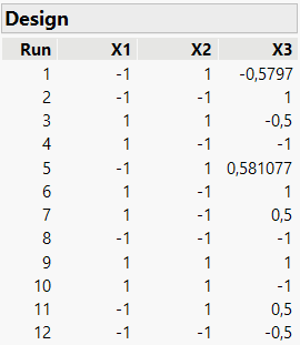

Adding this term in the model will create more levels on this factor in the design (4 levels: -1 / -0,5 / 0,5 / 1)

1. Calcium.  Why is this discrete numeric (vs. continuous)? Why are you testing at 7 levels?  This will bias the effects in the experiment to calcium.  Do you really need to estimate a 6th order effect?  (And you will get some extremely complex interactions). It seems you already know this is important, so is the question how important is it in comparison to the other factors in your study?  Does it interact with other factors?
2. Ratio of ammonia to potassium.  Agreed with question of factor type(Victor). Since you are experimenting on Ammonia, seems like this is really just amount of potassium?  (Levels could be set with ratios in mind).  Is this actually a mixture of ammonia and potassium (perhaps a mixture design)?  Does the ratio depend on ammonia concentration?
Look at the dots on your experiment.  Do they seem to be balanced throughout the design space?  It appears biased to me.

@Victor_G _ I will definitely convert discrete numeric to continuous factor. For calcium concentration, I love the idea of changing the numbers to log scale. However, I did not understand what you meant of "you're not forced to use a discrete numeric factor to cover a broad range of levels : specifying a more complex model with higher order terms (set as "Necessary" or "If Possible" to not augment the required run size)"
I picked 7 different levels of calcium concentraitons in the initial design as I know calcium concentration affect the yield at wide range. If I change calcium concentration from discrete numeric to continuos factor, custome design will likely pick low, middle, and high points in the design space. I know I can do sequential design (augment the design) to find the optimal chemical reaction. However, based on the historical data it might be hard to know which direction to go if I only have three levels of calcium concentrations. Is there a way to include one or two more levels of calcium cocentrations without having to do discrete numeric.
