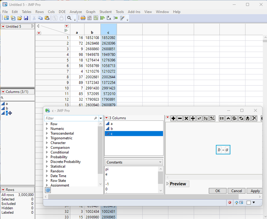

Running Windows 11 and JMP 17.2, I created a data table with 2 columns of 3,000,000 rows and then added a new column with the formula
 - :a
and the calculation of the formula row is virtually instantaneous.
Can you provide more specifics of your issue that might provide some insights?

I am also running Windows 11 and JMP 17.2 and I used a data file with 6 million rows and both tabulate and the formula column calculate almost instantly (1 second).  I suspect it is your hardware - on my older machines, things used to take much longer.  15 seconds sounds too long for the tabulate.  But I don't know if it is hardware, JMP 14 (which I no longer have to test), or a combination of the two.

I ran the same test on JMP 14 and while it was slightly slower, it did the subtraction in less than a second
