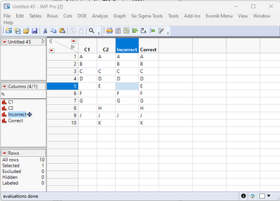

  Not sure why I'm having a hard time getting the correct solution to this, but I'm having a hard time combining columns of text when each column has missing entries that are not on the same row -- but all rows are aligned. See the screenshot below.
  For example, if a row has an entry A or B or C, then if it's within a column, say :C1 or :C2, then the row is the same for both columns. For my data table, I have many text columns, each of them has some missing row entries, see above example. I am trying to use a column formula that uses all the different text entries of :C1 or :C2, to :CN.
  I tried using the following column formula, but it doesn't fill in the column when :C1 Is Empty
  I thought the solution would be pretty straightforward, but I'm not finding one, and drawing a blank on how to fix this. The nice thing about this is that for columns :C1 to :CN that I have in my data table, if a row is not empty, then all columns will have the same character for that row. For example, all columns have The entry D for row 4 (unless it's missing). I'd like to end up with a column that has no missing values by using the non-missing entries for each of my :CN columns, like the column above :Correct.

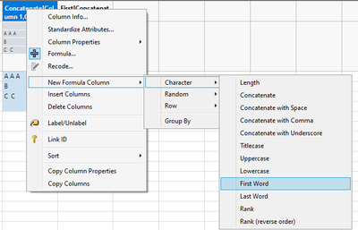

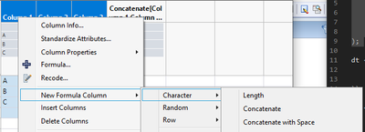

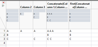

You can also Concatenate With Space
And then create other column which is First Word
Similar thing can be done with Cols/Utilities/Combine Columns and First Word column formula
