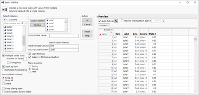

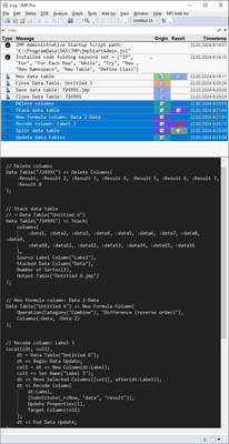

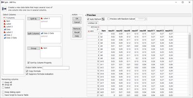

If you just care about the results, other option is to stack your data, calculate the result to stacked table, split it (might have to add new column for proper result column naming) and join it back
and then JMP is able to create some sort of a script for you

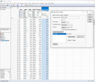

WebDesignesCrow
Re: Subtract between multiple columns

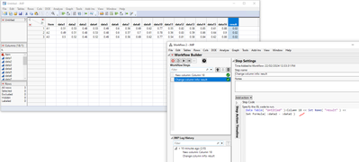

Hi @kuanaunwei ,
For me, the effective way to learn the correct script is to use "Workflow" (I'm using JMP 17).
Below is the how I would do it;
I use button-click to get the result manually - then, check the code at "Workflow". Add it in my script
From your JSL script above, I'm not sure, whether you just want to have a simple formula column or formula column with conditions (IF/Else)?
kuanaunwei
Level III
The column names will be different, and the size of the data will also be different. So workflow might not be a best solution for my case. Thanks for the recommendation
