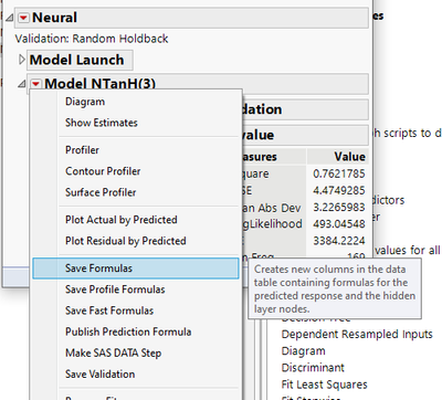

From the neural platform you can save the formula to your table
and move it (or all of them, depending on your model) to other table if both have similarly named columns. Below is one example script

If you have JMP Pro you can also use Formula Depot which makes this maybe a bit easier.
