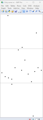

I am able to see in the log that the original vc_rpt has 6 Frameboxes as expected, but when I try to subset them based on the Framebox number seen in the "show tree structure", no graph is appended. I have also tried wrapping it in an additional V List Box and similarly nothing has worked to add to the new window. Any help would be greatly appreciated. Thanks!

Your error is in thinking that all of the images are in one report.  Instead, there are 6 reports, each with one image.
Therefore your code needs to be changed to looping through a specified report and grabbing framebox(1) from each report.

I am also thinking that you might not want to be pulling just the FrameBox(), but instead pulling the PictureBox()
