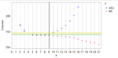

Stepwise regression: history plot. Why yellow band = min(BIC|AICc)+10 and green = min(BIC|AICc) + 5 ?
In both the stepwise regression and in the generalized regression there is a yellow and a green band in the history plot of the V (goodness of fit)  were v is either AICc or BIC.
The instruction manual tells that yellow is  min(V) + 10 and green is min(V) + 5.

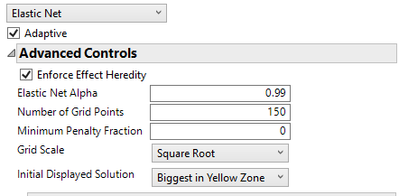

In the generalized regression platform it may also be used as a stopping rule like 'biggest inside yellow'.
But why the +10 and +5 and has there anyone justified those values in a monograph or a presentation or another referable source?
And why did JMP deliberately choose those 2 numbers?
Related pic:
Looking forward for feedback! :)
