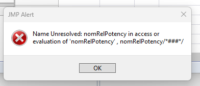

I am trying to do the Stability Analysis Training course but I get this error message when I try to generate the very first stability data:
Any idea what the issue is? This is from the training notebook provided by JMP. I'm using JMP 18.0.1

This error typically occurs if you did not click the Initial Setup link at the top of the journal. I could only reproduce your error by clicking on the first data table WITHOUT clicking on Initial Setup.

Thanks! That was the mistake i made.
