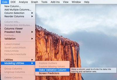

Jeff_Perkinson
Re: Split data into training and validation without JMP Pro
In JMP Pro 12 you can use Cols->Modeling Utilities->Make Validation Column utility.
-Jeff
