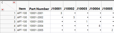

I am having problem to split columns and transpose it as header and value. Need help here how to write the code.
My data table has four columns, Item, Part Number, Order Number and Quantity.
I need to split Order Number and transpose it as header in new column and split Quantity column transpose it to respective cell.
I attach my data table here and required outcome for your reference.

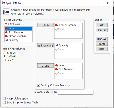

What you want can be accomplished using the
     Tables=>Split
Below is a simple script taking the JSL provided from the Split Platform, and then just adding on the JSL taken from the Recode feature

Hi,
I am not sure I understand your problem: if you do a simple Split of column Quantity by "Order Number" and group by "Item" and "Part Number" you get the outcome as shown in your post with the exception that the missing values are coded as "missing" and not "0".
With a simple Recode from the Standardize Attributes, you can set all missing values to zero.
Assuming that I did not understand your initial request, could you clarify what part of the process did not work for you?
