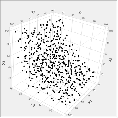

Phil_Kay
Staff
Re: Space Filling DOE, with Fast Flexible Filling, using table Constraint of factor2(factor1,factor3) to limit DOE space.
The attached example might be useful.
I created a FFF space-filling design of 1000 runs for 3 factors. Then I added a formula column to define the constraints. The constraint is completely made up and not very complex but it could be anything...
If( Ln( :X2 * :X3 ) > 8,
	0,
	If( Ln( :X2 * :X3 ) < 6,
		0,
		1
In this way you can define a space-filling set of design points that meet a complex constraint.
