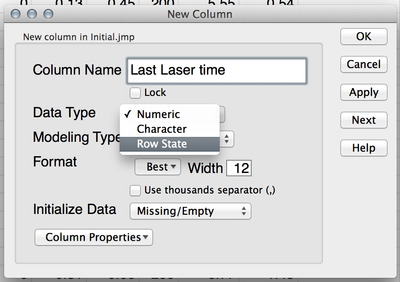

Choose Cols -> New Column... and set the data type to Row State.
Then add a Formula.

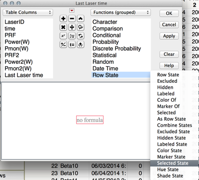

For the formula, start with Row State -> Selected State.
Then put the comparison inside the Selected State() function. This comparison uses the Lag() function with a -1 argument to compare with the value of LaserID in the next row.

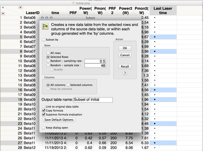

Now you just need to copy the row states in your new column to the active row state area by clicking on the star icon in front of the column name.
Now you can use Tables->Subset to subset the selected rows.
