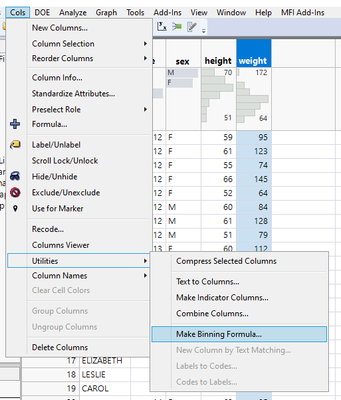

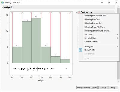

Select your column and create binning formula
There you can find few different options for the binning
