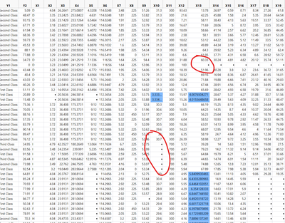

I have a file with missing values. I want to impute these missing values In place with JMP Pro's ADI method, for columns X2, x10, X12-X16 (see attached file).
However, when I apply the method, not all missing values are imputed. What's the reason behind this?
Imputed values are highlighted in blue, and non-imputed values are circled in red below.

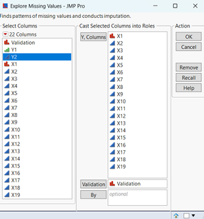

Can you provide a snapshot of the ADI platform when you launch it, and more details about the columns used ?

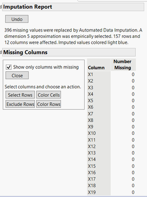

I was not able to reproduce the errors you obtained with the default configuration of the ADI platform, all missing values can be imputed with the default recommended settings. It might be a problem in the settings of the platform that prevents from imputing all missing values (for example an inappropriate dimensional space), or the selection of columns.
Here are the steps I did :

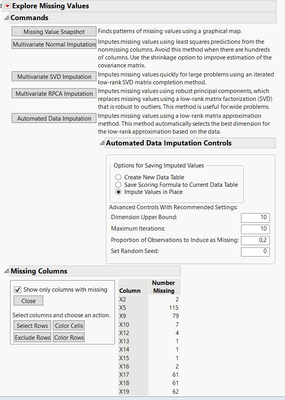

  • Selection of the columns in the platform for data imputation :
  • Default recommended settings for ADI :
  • Results obtained :
I attached the datatable with imputed values and the script for ADI.

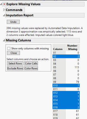

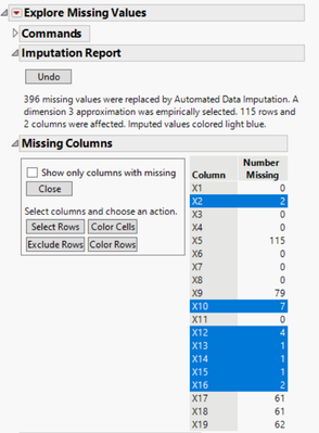

Hello @Victor_G ,
Thank you for your response. I let the default configuration of the ADI platform like you, with random seed of 0.
The only difference between what you did and what I did is that I wanted to impute the missing values, but only for the X2, x10, X12-X16 columns, not the other. So, before clicking on the ADI imputation button, I first selected these columns via the imputation report (as shown below) and then launched ADI imputation.
It's true that if I don't select anything beforehand it works, but I naively thought that I could select the columns where I wanted to impute
