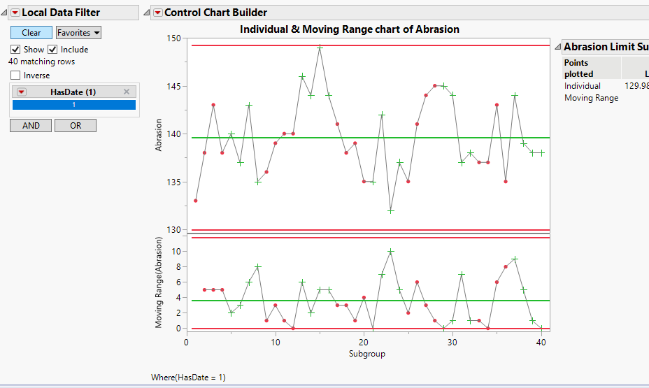

I am a big fan of using transform columns right inside platforms.  Here is how I created the control chart part of the script below:
  1. Create the control chart using all data
  2. In the control panel, right click on Date and choose Formula
  3. Add Is Missing and Not functions so the formula is true when the column Date is not missing and close the dialog
  4. Right click on the new column and rename it to be 'HasDate'
  5. Right click on blue triangle next to the new column and change it to a Nominal data type
  6. Add a local data filter, the transformed column will automatically show up in the list of available columns
Here is what you should get:
And here is the script to re-create it:

If after you decide that is a helpful column creating a visual or doing an analysis , you can right click on it and add it to the data table.
