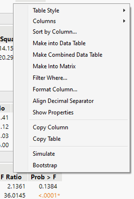

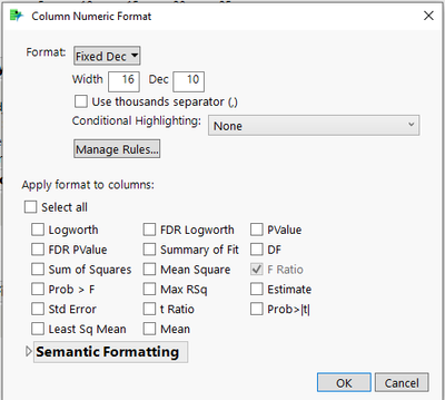

jthi
Re: Slight difference in p-values under “Combine” rule (before vs after entry)
You could try changing the column formatting for the F-ration by right-clicking on it to verify if there is a difference

Thank you for your explanation!
After checking carefully as you suggested, I found that the small difference in the p-values actually comes from a slight difference in the F ratio between the two situations.
Could you please help me understand why the F ratio itself is not exactly the same in these two cases?
